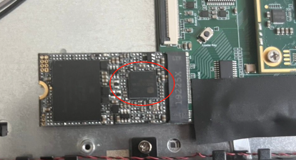

      I just bought CM5 laptop. and it came with this 1TB NVMe SSD.S__23461896_0.jpg
      S__23461894_0.jpg S__23461897_0.jpg .
      I plugged it to the laptop. it's not shown in the Disks App that's understandable b/c it's a brand new. So, I followed a lot of instructions on how to formatted it.
      (I dont know how to get to CM5 laptop BIOS/UEFI to enable AHCI mode)
      most of the command result like there is no NVMe plugged.
      So I used "dmesg | grep -i pci" to get error related to PCI and got this.

            Confirm the specific model of this chip and send it out for me to check the specification sheet.
            R 1 Reply Last reply Reply Quote 0
            • R
              rtmtree @george last edited by
              @george It's
              2342
              SM2259XT2G AA
              THXW90.00
              CH 2H

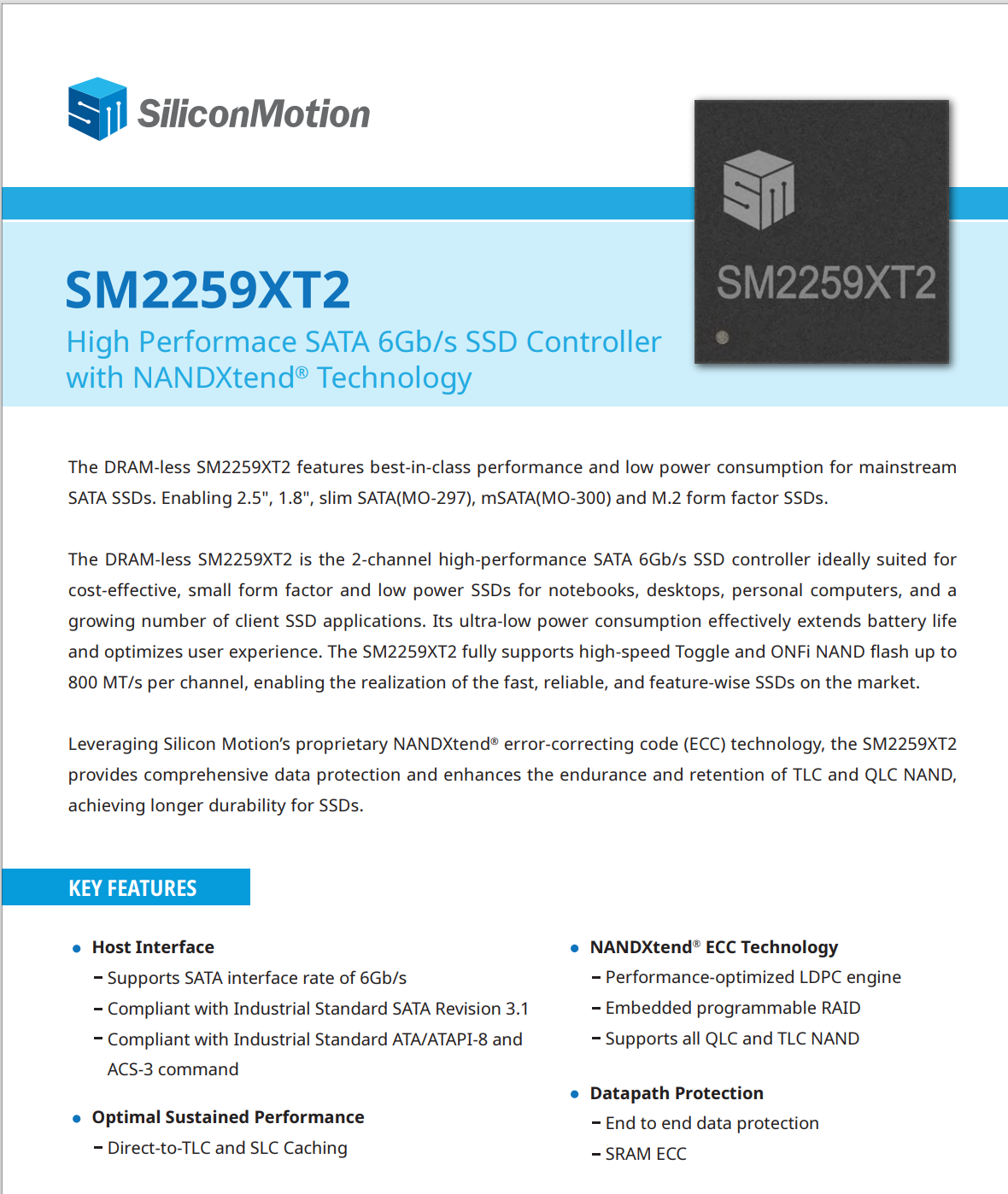

                george @rtmtree last edited by
                @rtmtree
                As shown in the figure below, this control chip only supports the SATA3.0 protocol.
