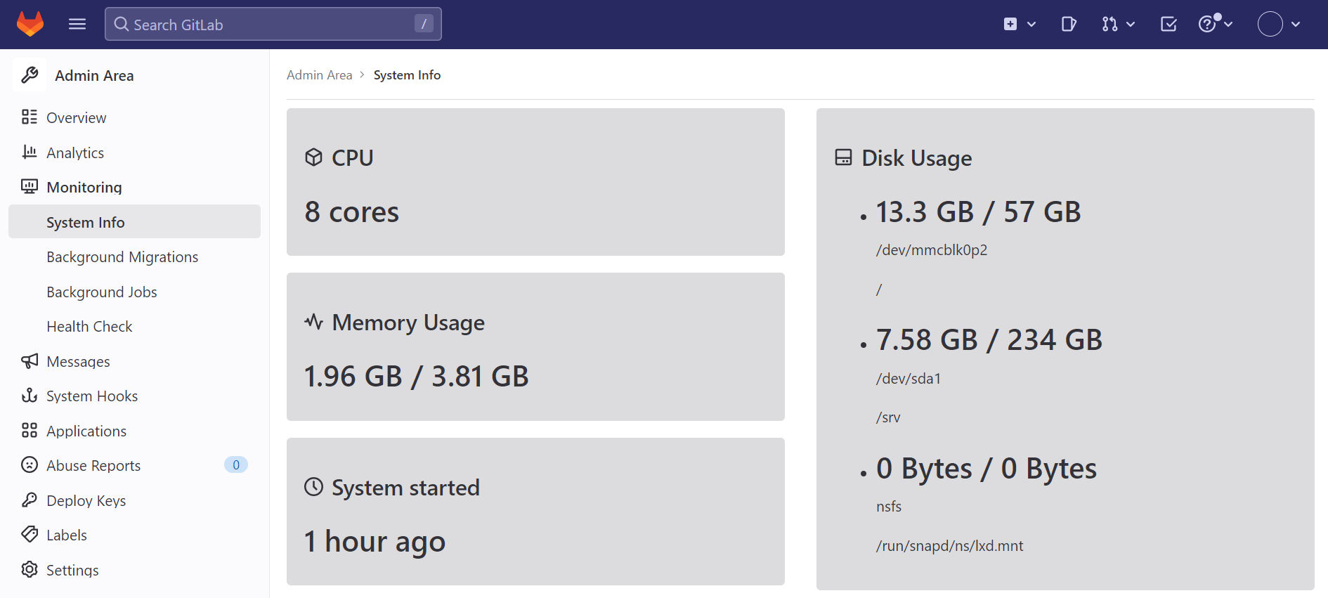

      浏览器访问http://localhost 或者 http://192.168.1.172
      大法师 1 Reply Last reply Reply Quote 1
        大法师 @大法师 last edited by
        nice board for server!
