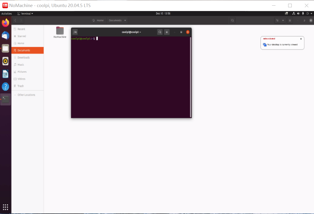

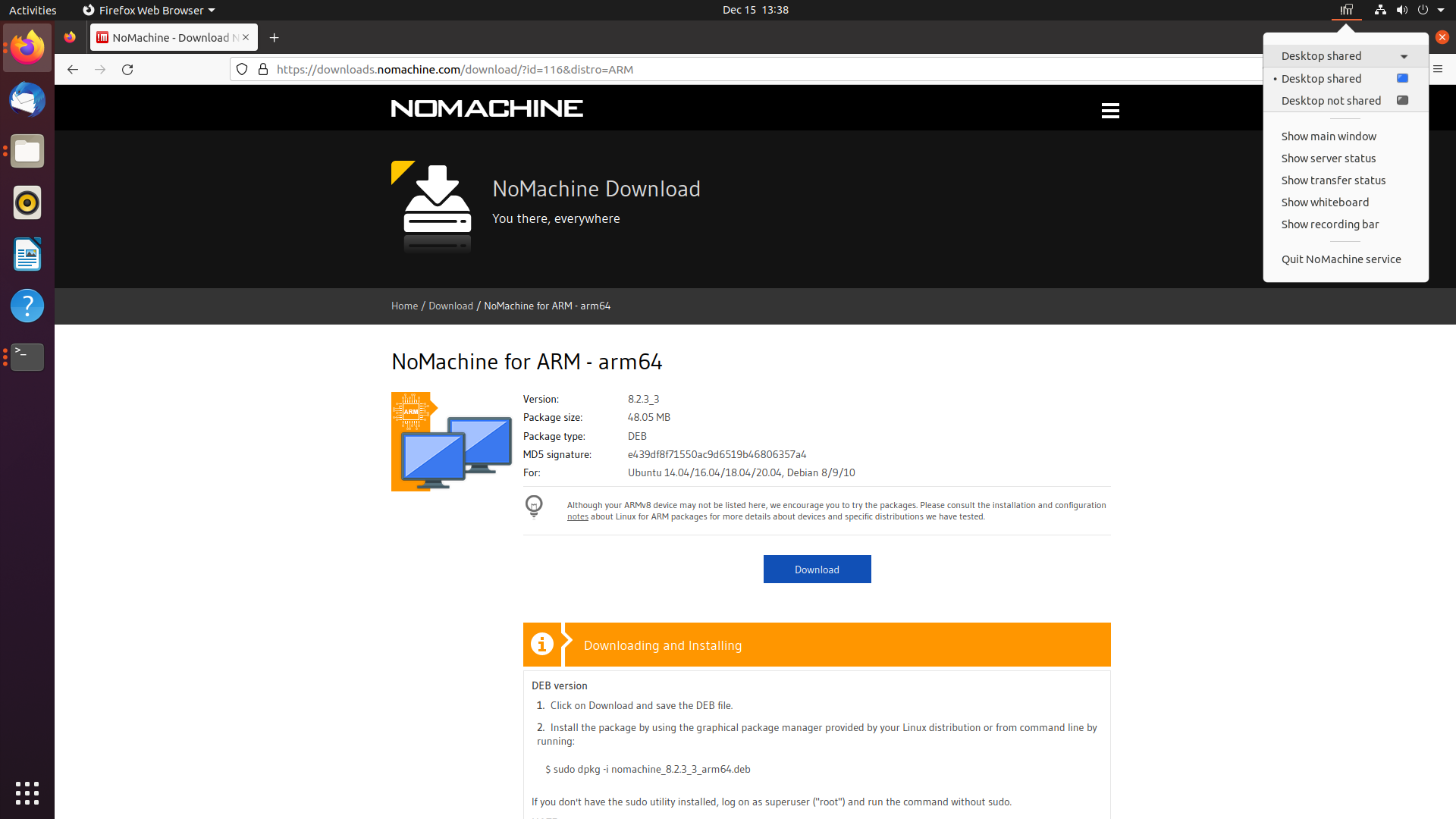

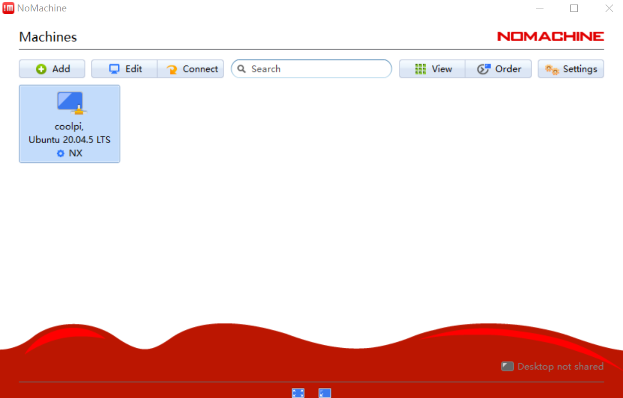

                    @大法师 这个镜像不能安装 远程工具nomachine
                      jack_admin @ccjjww1222 last edited by 大法师
                      @ccjjww1222
                      why?
                      https://download.nomachine.com/download/8.2/Arm/nomachine_8.2.3_3_arm64.deb
                      coolpi@coolpi:~/Downloads$ sudo dpkg -i nomachine_8.2.3_3_arm64.deb
                      [sudo] password for coolpi:
                      Selecting previously unselected package nomachine.
                      (Reading database ... 141964 files and directories currently installed.)
                      Preparing to unpack nomachine_8.2.3_3_arm64.deb ...
                      Unpacking nomachine (8.2.3-3) ...
                      Setting up nomachine (8.2.3-3) ...
                      NX> 700 Starting installation at: Thu, 15 Dec 2022 13:35:52.
                      NX> 700 Using installation profile: Ubuntu.
                      NX> 700 Installation log is: /usr/NX/var/log/nxinstall.log.
                      NX> 700 Installing nxrunner version: 8.2.3.
                      NX> 700 Installing nxplayer version: 8.2.3.
                      NX> 700 Installing nxnode version: 8.2.3.
                      NX> 700 Installing nxserver version: 8.2.3.
                      NX> 700 Installation completed at: Thu, 15 Dec 2022 13:36:15.
                      NX> 700 NoMachine was configured to run the following services:
                      NX> 700 NX service on port: 4000
                      C 1 Reply Last reply Reply Quote 0
                      • C
                        ccjjww1222 @jack_admin last edited by ccjjww1222
                        @jack_admin 我昨天的测试不行,安装后,机器都启动不了,我买了个小显示器取代了
